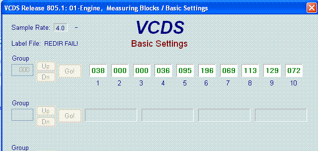

Tak na TDI grafu mi to pise tohle: timing is too retarded to be plotted takze to bude asi tim predvstrikem jak rikal Tomas.
